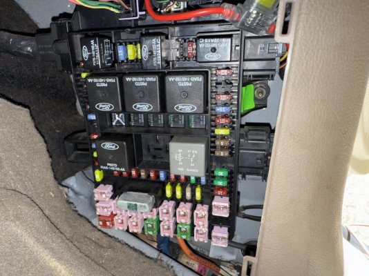

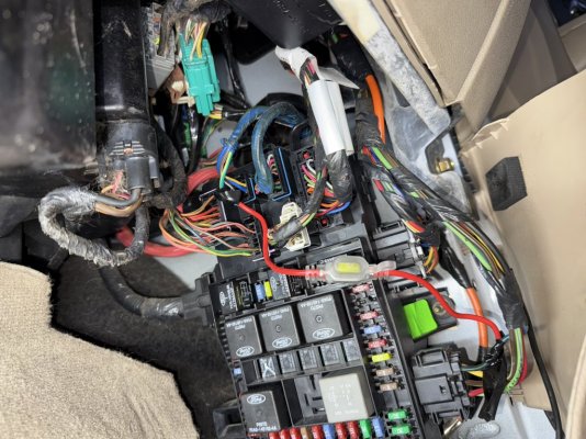

The only code that showed was battery voltage out of regs.. it’s a brand new battery and I had the battery and alternator tested at O’Reilly 2 times and the first time they said the battery was bad so I replaced it and the second time they both checked good. Here is a picture of my fuse panel. I noticed a few fuses are missing and also there is a red wire with a fuse inline that is jumping the dark green / yellow wire from one side of the fuse box to the other. What is that for?

One thing I did realize. The fuel relay is jumpered and the jumper has a fuse. If I pull that fuse the engine turns off BUT I can hear the rear ac blower still faintly blowing through the air vents. The front vents shut off. But if I disconnect the battery and alternator everything shuts off and resets as if I turned the key off. Something is energizing a relay somewhere. I am waiting on a replacement fuse box and will swap that and the fuel pump and fuel filter out just to make sure.

Swapping the fuse panel is a good idea. I'd consider removing that rigged up wiring the fuse panel as well.

I agree… the more I search the more it sounds like it’s the fuse box. When we towed it home I remember it rained real hard and I see that this expedition is notorious for leaking on that side into the fuse box. The new one will be here Monday so when I take the old one out I will see if it was damaged by rain and how bad. Either way it had to be changed. I don’t know why they solder those middle relays in but make the rest changeable.

So the more I researched the more I started to see posts about other people’s issues that were similar to mine outside of the engine not shutting off that related to the fuse box. So I dug further and saw it can also cause the engine not shutting off as well. So I swapped the fuse panel and it fixed it. The truck now turns off when the key is turned to off. It hit me that the day the compressor seized we towed it to the house and while towing it was torrential rain and realized the engine not shutting off had nothing to do with the compressor change. I thought I broke something while changing it but it was the rain. It’s hard to troubleshoot a new problem after you changed something and it’s completely not related. But I am so glad I found it. The owner before me jumped the fuel relay with a wire that had a fuse inline. I already knew the fuel relay was bad just by that but trying to figure out why the engine wouldn’t shut off threw me for a loop. It was also draining my battery dead. The fuse box had multiple issues. Such a ****** design and poor placement right where water leaks in. Now to find the leak. Probably the sun roof drains.
