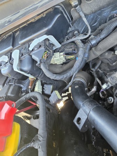

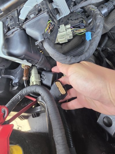

Important Finding​
There is a connector located near the BJB in the engine compartment.
When this connector is unplugged:
  • The A/C compressor clutch immediately de-energizes
  • The clutch no longer remains engaged
This seems to indicate that the power/control path is passing through that connector or harness.
