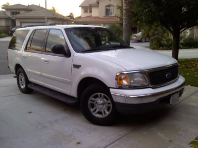

My 2000 4.6L keeps reving between 300-1000 rpm when in park. Idk why, only in park. Not at a stop sign while driving though. Any ideas? Thanks :)

Is it a constant change in RPM, or does it change every little bit, because it is normal to change rpms every once in a while. and does it do it while cold and warm?

check the elbow in the back. if you never changed it it could be that. i had that issue when the elbow went bad.
