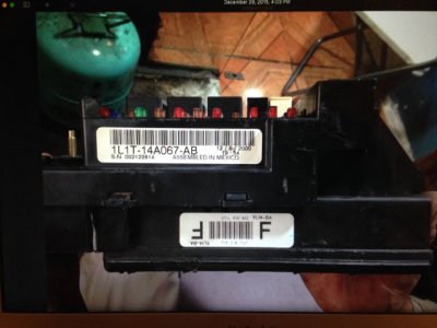

I live in Saudi Arabia and have a 2001 2WD Ford Expedition with a very strange problem. All cars in the Middle East are equipped with a beep that kicks in as soon as you go over 120 kph. In an attempt to get the beep disabled, my incompetent mechanics (who speak no English) somehow stopped the beep, but now when I hit 120 kph my windshield wipers start wiping at full speed. Once they start, the only way to cut them off is to drop my speed back down to 110 kph. I've also had problems with false door ajar alarms and blinker issues ever since these mechanics attempted to fix my initial problem. They have told me that I need a new "body control module." I've attached a picture of the part they showed me, and it appears to be 2 parts. I can't figure out what to buy here in the U.S. before I go back to Saudi for the next year. Can anyone point me to a reliable website to use to buy a replacement part (cheaper the better—used is fine) and help me identify what exactly I need to order?
