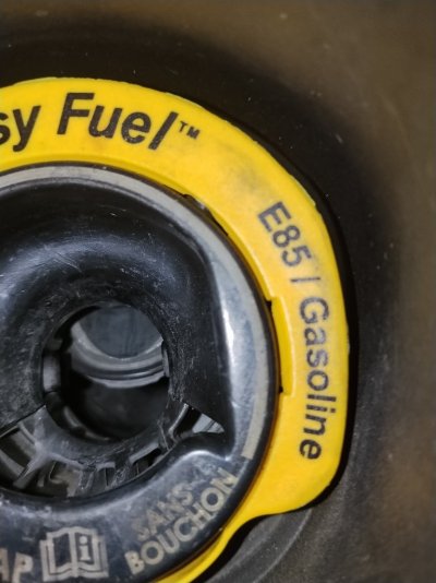

Hi Expy owners,
as you can see from these photos, I cannot put gas in the tank due to that filler-thing cap being broken/wrong position. Which I think is the reason behind DTC codes P0455, P0457.
What is the name of such part? can it be replaced?
I dont have the ford plastic fuel adaptor, suggestions are welcomed.

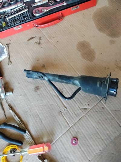

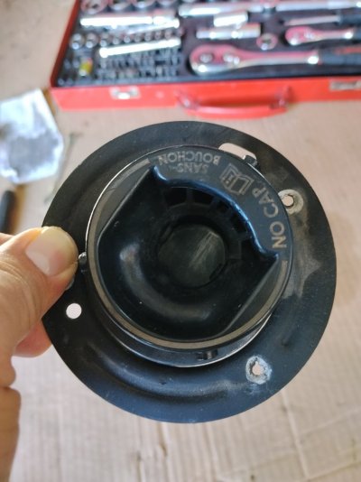

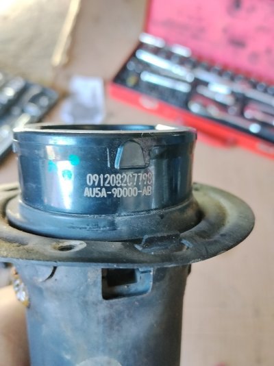

Well, it is fixed. About two hours of work mainly because the Mechanic has never performed such fix.
A local mechanic was able to remove the fill neck and replace the broken spring.
