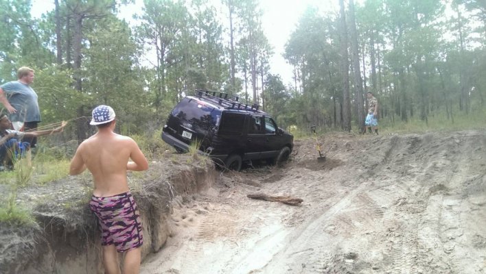

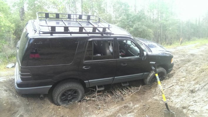

What's the difference between the 2nd gen's A4WD and the 4high? Cause I got my Expy stuck in Citrus Tract when I drove it over a 3' embankment, and I thought that 4high locked, but all I got was two opposite wheels spinning: the ones I didn't need. Probably wouldn't have got me out, but what does the a4wd do if the 4high doesn't lock? e7y6e9y9.jpgqeqe3yje.jpgmu9yzyvu.jpg

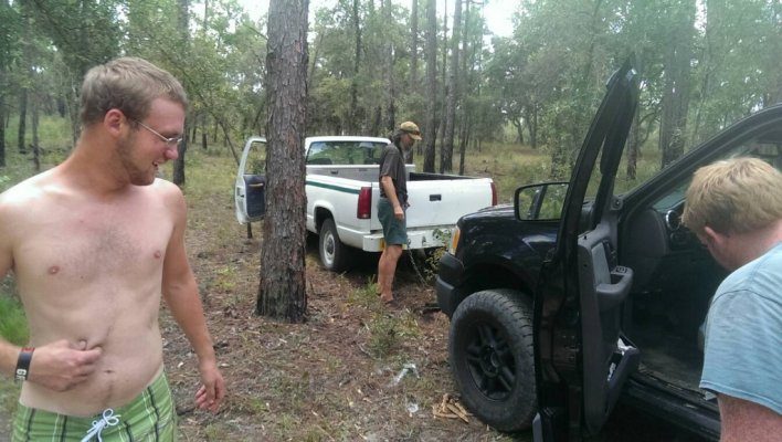

Haha, unfortunately....I have to hang my head in shame...lol and when it was teetering the left side of the front diff was leaking gear fluid, and while trying to self rescue, my front axles just kept popping grinding. Idk if there's something wrong with it period as my 4low didn't seem to engage at all . It kinda let me down. enede3yj.jpg

4 Hi locks the transfer case meaning you have power going to both the front and rear differential. A4wd engages the transfer case only when it senses slip.
Now if both front and rear differentials are open the wheel with the least traction (per axle) gets the power. So unfortunately if you have both a front and rear wheel with poor traction you may be screwed.. lol.
That's where advance trac is supposed to take over and apply braking to the spinning wheels thus sending power to opposite side.
If you have no advance trac a limited slip rear would be very beneficial for off road.
As was mentioned applying brakes sometimes helps as it can limit the spin on the wheels. The only problem is applies braking to all the wheels or both rears if you use the parking brake.
Lockers of course would be best for off road use. Then you can lock the differentials and all wheels get equal power.

Well, there are two problems I see here. My truck is an '03, an early '03: like probably the first built in 03(Jan, 03.) I do not have any kind of stability or traction control, second problem is that apparently my 4lo doesn't work at all. When I switched to it, nothing changed, abd no different lights besides the 4x4 which was already on came on. So that's a fix that's probably going to cost me some dang money.
