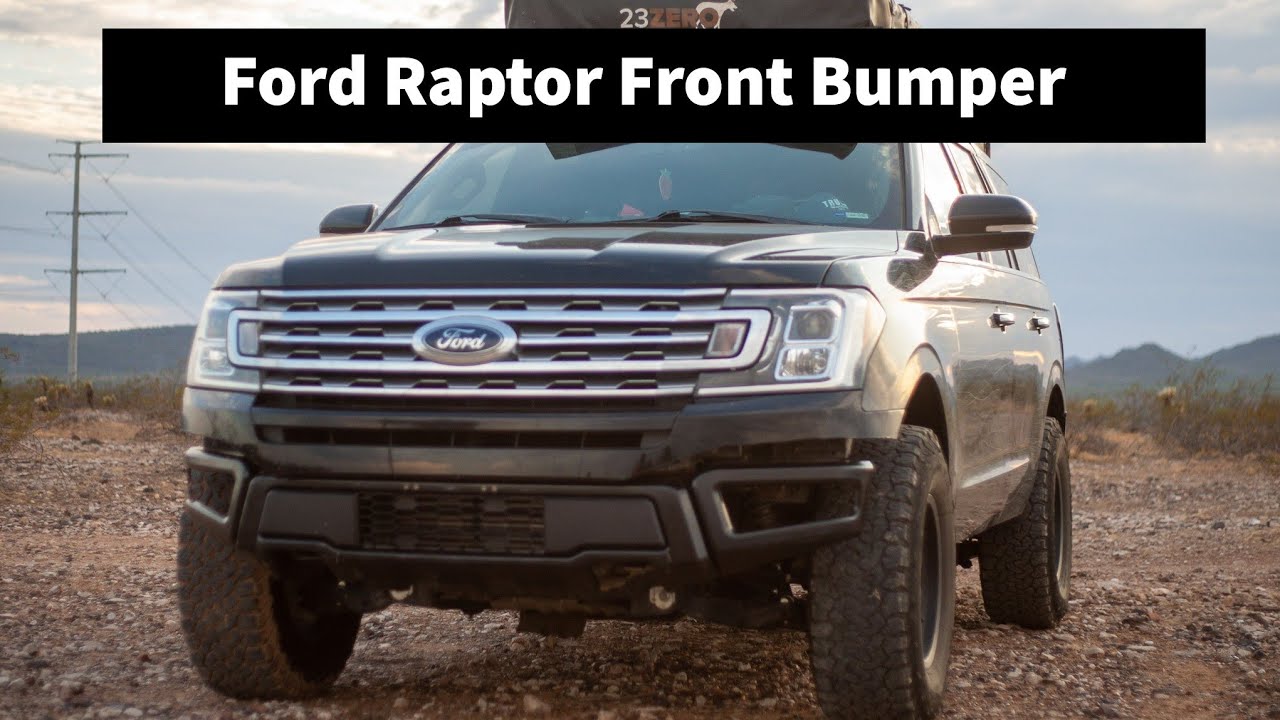

This guy at Kingdom Overland was able to bolt up a Factory F150 Raptor bumper to his 2018.
He mentioned in the video that there is a relocation kit for the Raptor to relocate the CAC for a winch install.
So it seems that a lot may be possible from the F150 market.
