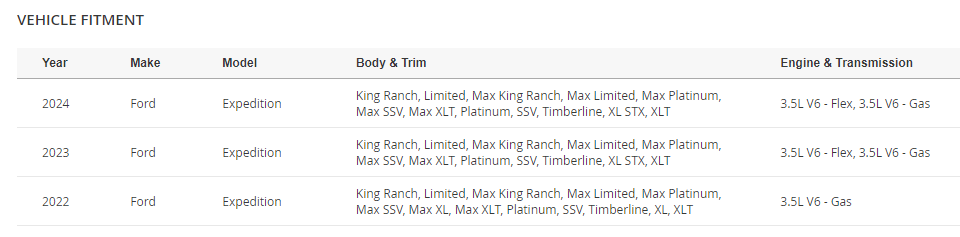

So my '24 Stealth Performance Limited Max is getting some accessories installed. I needed skid plates so went to Ford website and found the following, which says it will fit my vehicle. Dealer ordered it and went to install and said it won't fit; I told dealer to call Ford and see what they say. Ford says it is for a Raptor and won't fit. Dealer says his service guys might be able to fab up mounting brackets to make it work. Thoughts on the fabrication option?

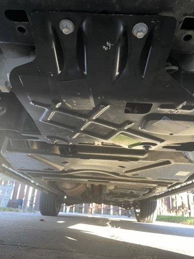

6 and 7 on part blow out fit. I put them on my 2020. For 7 you have to take the bracket off for the P.O.S. fabric thing and install a clip in hole and 2 more screws. Other then that, it fits. I elected not to put part 1 in to keep that front area open to see up through the bottom and replaced 6 for the other fabric P.o.S. This bolts right in with existing bolts. Just a reminder if you have Ford points use them for helping offset cost.

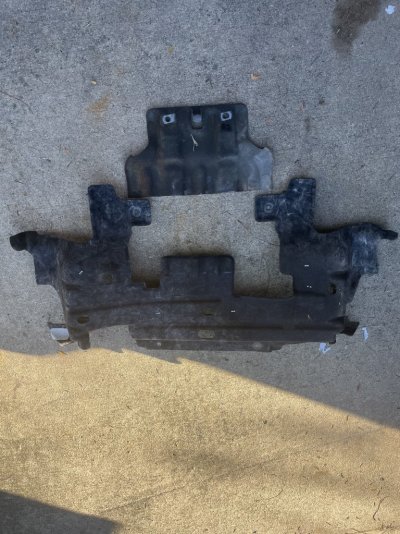

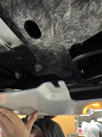

Update. Got the brackets ordered. Dealer was able to get everything installed EXCEPT the front skid plate! The brackets allow the front to attach perfectly but there is nothing for the rear of the plate to bolt into?!?! See pics. Any ideas? At this point, I'll need to get a bracket or fabricated. I'm in suburban Chicago. Any recs for a local shop are welcomed.
