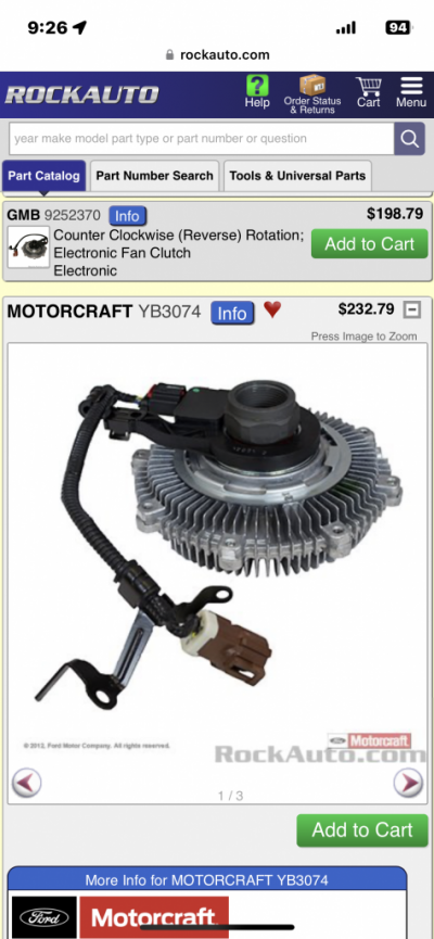

That looks pretty lazy to me. You should hear it roar if you stab the throttle. Looking slow and having hi a/c pressure point to the same issue, a clutch that's not engaging.
Looking at rock auto I agree with #twodollars, it's electric so either a pcm or fan controller is supposed to be sending it a signal.
Check your wiring and connectors closely, see if you're getting a signal to the clutch, and see if the clutch responds to the correct signal.
