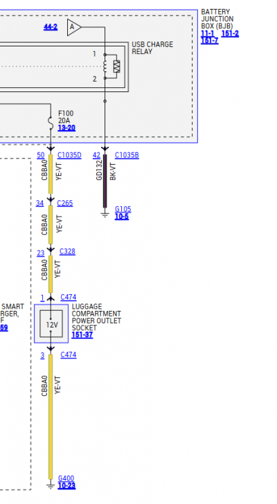

Aha, it's the Uniden R8 radar detector, which is set to time off after 30 minutes. (been set like this for 2 years, no issue before) And AFAIK the 12V outlets time out after 75 minutes.:uhoh2: So I unplugged the detector, the 12v adapter felt warm in my hand and waited 20 minutes and the fuse was no longer warmer than the others. Smoking gun!!
Problem solved I think but curious me went and pulled up the wiring diagram and fuse 100 is for the luggage power point according to alldata so now I am confused :(
So the plan of attack is to dig out forscan and set the time out to something like 10 seconds and confirm the 12v does shut down or not.

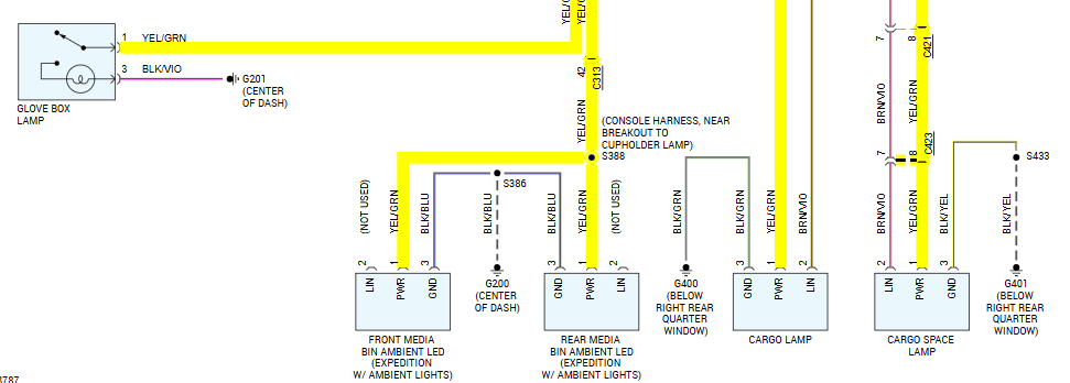

Went out and sure enough no power but interestingly the ambient light LED for the front bin where the USB ports and wireless charger are located and the rear radio console were lit up. I think the radio looked like it was back lit but was black, like when you apply power to a TV or monitor but its not got a signal? maybe? hard to tell.
No other lights, overheads doors etc were lit. The problem with these cars is as soon as you open a door lots of things come to life so diagnosing an intermittent like this is hard.
So quick review of the schematics shows that the front ambient led for the bin and the rear console get power from the BCM labelled "DEMAND LP/BATT SAVE (FET)" and gets its power from a 50A fuse 76
And that feeds power to lots of places like vanity mirrors doors etc but interestingly every other location is either a switch such as the glove box or vanity mirror lighting or a Lin controlled module i.e. it gets power but needs a network signal to turn on or feed power to the relevant light. Only the rear console and the led in the bin are directly fed power.
Still no idea why the BCM is turning that FET on and feeding power, current thoughts are radio doing an update, wiring issue/short/water or faulty BCM
