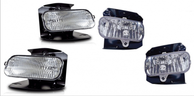

OEM Style (right)........New Replacement (left) Size not to scale in pic.
I am wondering if it is rather difficult to replace them or not? It appears to look like it might be an easy pop-out and replace and plug back in....but looks can be deceiving.

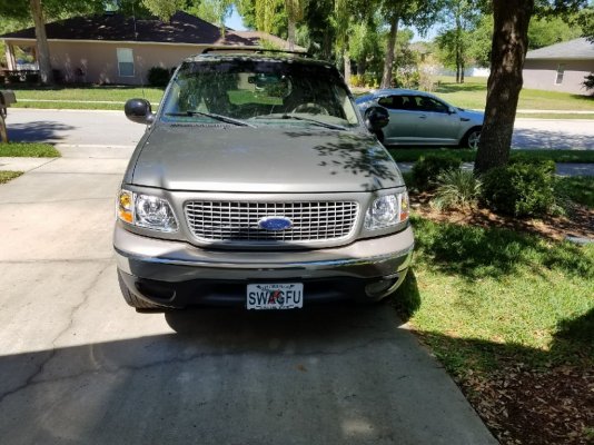

I did mine. I honestly didn't have any issues. Maybe 30 minutes total to do both sides. I did take it somewhere afterwards to have my headlights and fog lights adjusted properly. They only charged me $25. One tip I have is that you don't have to be under the truck really, I turned the wheels all the way to one side or the other and was able to do from there. You can kindof see at least one of them here.
And here you can see the headlights. I did these before the fog lamps. Together they make the truck look newer than it is.

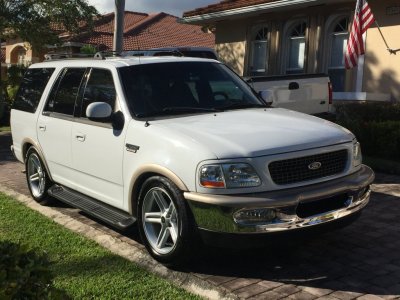

I used the Depo clear fogs on my 98. The swap couldn't have taken me more than an hour or so. It's even easier on the 99-02 style bumpers.
