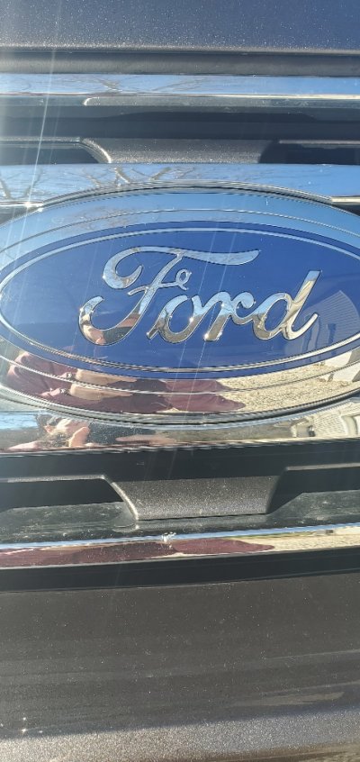

Camera is under front Ford logo on grille. Not sure why u gut error if no camera. Might go away after you turn off and restart car.

Go look at the front Ford emblem. Camera is a small dark circle on the bottom edge.
It gets cleaned when the front windshield washer fluid is activated.

This is my emblem. Pretty sure there is no camera. It didn't come back on when I restarted it but still really odd.80c3e6cd889ac83cb79bb8640ebe765a.jpg

The camera for the driver assist (Lane keep assist, Adaptive cruise control, and automatic braking) is in plastic cover behind the rear view mirror. The camera in the emblem is only for 360° and possibly the park assist which isn’t available on the XLT.

Ding Ding!! It wants you to wipe the little "opening" in the black painted area of the windshield opposite your rearview mirror.

This is spot on. I too have an '18 XLT Max with 202a. On frosty or foggy days the camera throws that alert until the windshield clears.
