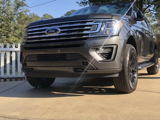

I know this has been discussed but can't find the answer in the search..
I've got a 21 limited and want to replace the big front valence with the shorter one that came on the FX4 model. I think this is the Ford PN - > JL1Z-17626-CA. Can anyone confirm?

If you look on the back of these, there is a cut line. I used a utility knife and followed that line, now I have a FX4 front valence.
Ah, nice. Did you remove it to cut it?

If/when you remove it (it is a combination of clips and screws if I recall, might be wrong, but it isn’t hard at all)…don’t be looking straight up at it. There’s a lot of grit and dirt that gets trapped, and gravity being gravity, send it directly into your eyes!
