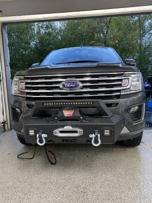

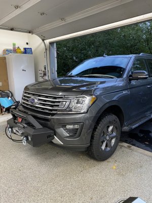

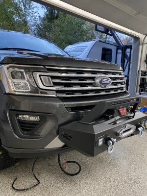

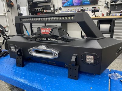

The only company making them for 15-17 Expys is Iron Bull. You might want to check with them. Have patience though... Here's mine on my 17.

I will second the recommendation of the Iron Bull bumper. Johnnie at Iron Bull was good to work with and despite what others have experienced, my bumper arrived very quickly. Fit was pretty good - just a little tight to the fender flare on the passenger side, and it required some modification of the attachment of the grill. Will post some photos once all is finished.
HawX66 - Have you had any success in getting your factory front parking sensors to fit into your new bumper? (I see you have the the holes). I just got my Iron Bull installed this week and went to run the wiring harness for sensors and fog lights last night, discovering that the harness is too short to reach the holes in the new bumper. Based on the way the sensors work, I am concerned about soldering extensions into the harness due to the added resistance. I have ordered some grommets from a 2010 F150 that I hope will hold the sensors themselves. I don't want to be constantly reminded by the dashboard display to "Check the Front Parking Sensors" though. Thansk in advance for your thoughts.
