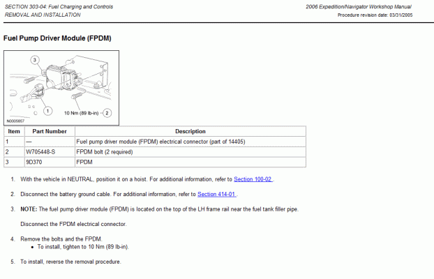

Check vacuum lines for cracks rotted lines. Need to pick up a smoke machine, you'll use it more than you think on these. Also check the Fuel Pump Driver Module on the frame since you live in Salt the roads country. May be corroded at mounting bolts.
