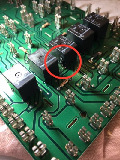

Based on reading the forums here I had suspected the fuel pump relay and had been meaning to check and replace if needed. The engine stopping forced me to jump in. Because the fuse box is pretty easy to remove, I skipped jumpering and testing, and went straight to removing the box. A quick inspection showed R303 partially melted and one solder connection fully degraded.

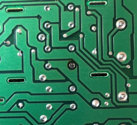

I carefully unsoldered the bad relay being extra careful to not apply too much heat. I didn't want to damage the degraded solder pad any further. A solder sucker and solder wick was used to removed the old solder. Again, tried to be extra careful not to overheat the solder pad. I cleaned up the site and new relay with rubbing alcohol, applied a tiny bit of solder flux to the relay, inserted the new relay and soldered it to the board. The solder flowed out 100% on 3 pads and about 95% on the other two. I cleaned off any flux residue and put the box back together.

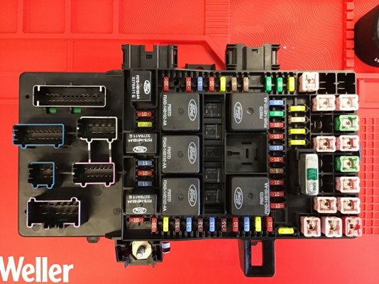

Here's a shot of the finished box. You can see the middle relay is different than the two above and below it.

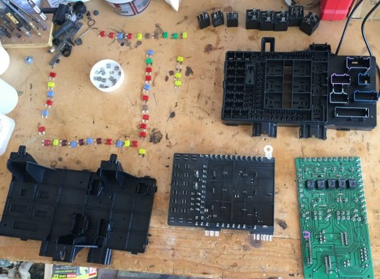

Here is sort of an exploded view of all the box pieces while apart.
