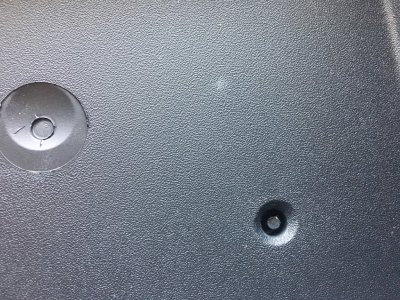

Anyone figured out how to open up the center dash to get the radio out? It looks very similar to the older F150 or Expeditions, but there are two hex screws in the top tray that need to be removed. But the hole around the screws are too small for any normal hex wrench or socket? Is there a special tool to remove them?IMG_6046.JPG

I figured out that they are not screws. Just a weird spot where the piece is molded. After taking out the two screw in the back of the tray you can pop out the tray with a small pry tool.
