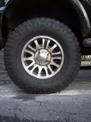

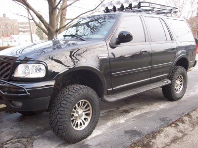

So I figured I'd keep a review of these tires as the season progresses.
So Far I've only driven on the dry highway with them.
Road noise was 6/10 only loud noise was above 85mph
They balanced ok, no vibration even on smaller then recommended rim width.
They do rub the inner frame and suspension on full lock.
They seem to have affected the mpg a little. ( will keep track)
I'm glad they're "snowflake/mountain" rated, hopefully that will mean safe winter drive.
Too Bad the rims are ugly !! but hey there for winter
