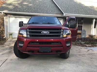

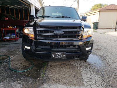

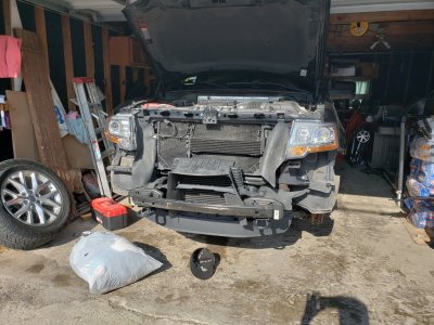

Any tips on grill and foglight removal on a 2016. Any hidden clips or sweet spots to help remove them?
Going to be doing away with the chrome.

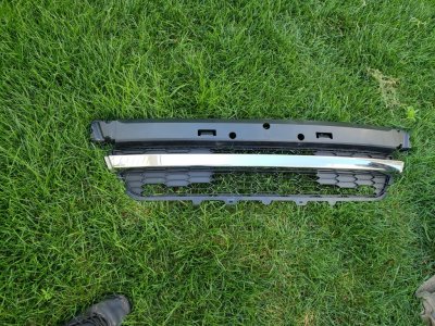

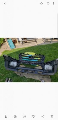

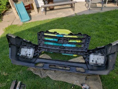

I've only removed the fog lights after having removed the bumper. They're just screwed on. The grille is screw clipped on to the top trim and to the bumper for sure but I can't remember if it's attached on the sides. To verify, It's really easy to remove the headlights (two bolts on top & pull straight forward after releasing the top clip) . Doing so will give your hands some generous room & help you see behind the grille.

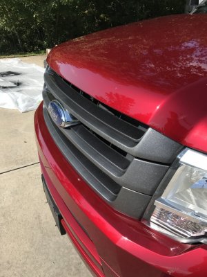

The SSV (police fleet) grilles for the 2007-2014 are a low-luster black as is the 15-17. You can clear-coat one of these for a gloss. This guy wants $270 for a used, unplated piece of plastic:
https://www.ebay.com/itm/07-08-09-1...311346?hash=item2ab4e19df2:g:vMEAAOSwiZZbjlrW
There is also a black chrome grille that was used on some year black Limiteds. Some other year black Limiteds had a high gloss (painted) grille. Look on ebay.
