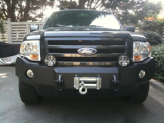

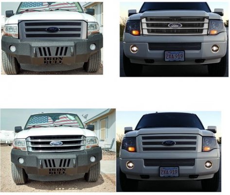

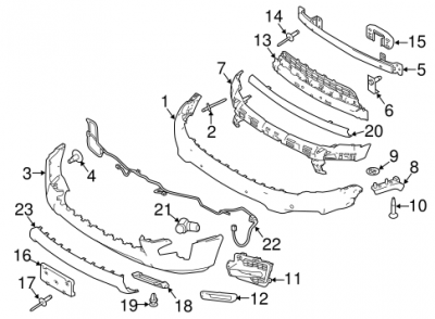

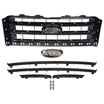

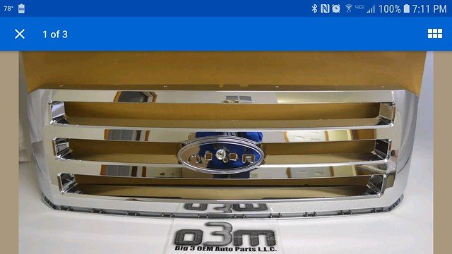

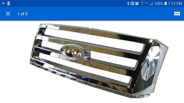

How do you figure it's nothing like it? The basic shape is identical so I'm having a tough time seeing it. The hood line is identical. Are the sides on the 15-17 angled and the 07-14 not? I wasn't sure if it was an optical illusion or not...

If you wanna take some measurements id be happy to measure my 07 grill to compare. I don't think they are as close as you think but are roughly the same shape

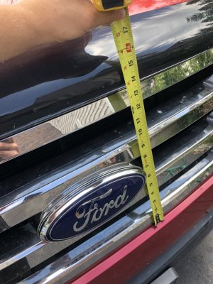

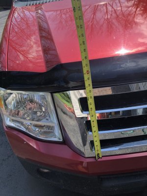

I have a feeling the 07-14’ grille is slightly bigger. I say this because the headlight assemblies are supposedly bigger on the original 3rd gens and the grille sits flush with the bottom of the headlights on both. I could be totally wrong this is just going by your pictures.
6,510
3,124

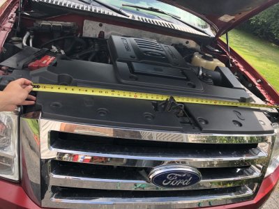

How about we have a user with a 15-17’ measure the height of their grille....that should give us an answer. Width is hard to see at this angle but its roughly 45” if you are in front of the tape.

I'd say the height and the width of the very bottom between the headlights would be telling. The top we know is the same because of the hood. The depth would have to be the same because of the hood also.

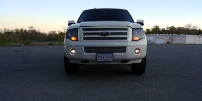

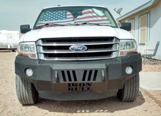

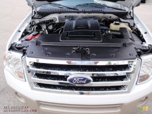

And height it is... Check out the difference between the top of the bumper and the bottom of the grill in these two pics. The bumpers both mount the same.
6,510
3,124
Yes the grille on the black one is definelty bigger. It covers the outline in the bumper where the white trucks doesn’t.
