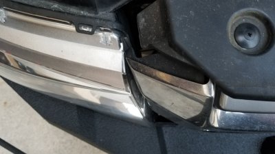

When manufacturers like Ford do a "restyle" like this, for some reason they often make sure the newer, more updated parts can't easily be installed on older vehicles. They always seem to change just enough to make it extremely difficult or impractical to upgrade an older vehicle. In this case, the entire front fascia was changed. This includes the grille, headlights, fog lights, front bumper, and all the structure underneath.
The 2007-14 parts are pictured above, the 2015-17 below:
