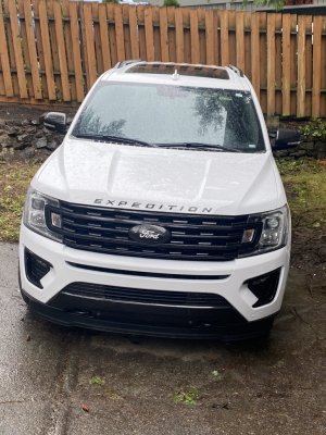

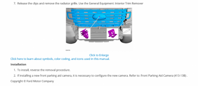

Welp, about to attempt this myself. Got EVERYTHING else blacked out except the grill, so now time to tackle this. Pics to come, with lessons learned.

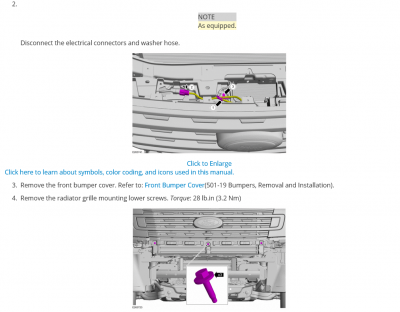

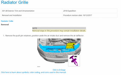

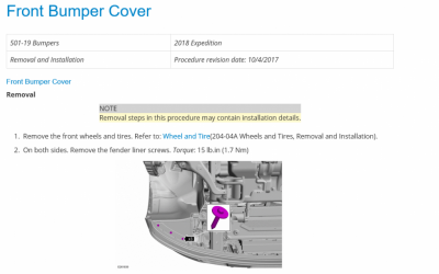

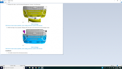

Im taking this slower than i wanted with the rain, but once i got the fender liners removed, It looks like the bumper cover shall be fairly easy. I found this pic, which almost shows all the tab/bolt locations.

Can easily be done by yourself. Just get a tab puller and a plastic trim removal kit.
Took me 2 hours by myself to get the bumper cover and grill off.
Those last two hidden tabs in the corner of the grill were tough, only because I couldn’t locate them.
