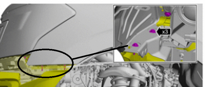

Having trouble getting the bumper cover off. Where are the bolts in step 5 of the above directions and how’d you get to them? Thanks in advance!

Sorry for the late reply, If you havent figured it out, i zoomed in on the picture maybe it will help. if not let me know

Thanks! I think I get it now. So, the bolts are screwed in from above, correct? I was looking from the the bottom and couldn't see where these existed. Was it difficult getting to them from above?

I can confirm that getting to those bolts was a bit tricky.
