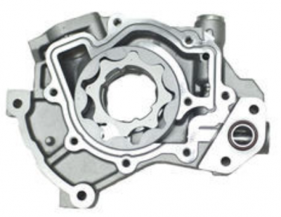

It was directed at everyone; hoping someone knew whether the EB engines have a pre-start oil pressurization design/system. It dosen't matter what oil or oil filter is used. If, at start-up, the critical lubrication points are void (or nearly so) of oil, that's a bad design.

It’s a mechanical pump thus no pressure until the motor is cranking. That’s why if you hold the gas pedal to the floor when you push the start button (with the brake) it will just crank and not fire. Do that for 3-5 seconds let off the gas and it fires with no sound at startup.
I did run by the dealer this morning to ask about that SSM. He pulled it up and it does state a TSB is coming fourth quarter 2019.

Well, that would explain the issue. So depressing/holding the accelerator to the floor at startup will allow the engine to crank but not fire?
Regarding the TSB, did your dealer say what Ford is offering to do? If they are just replacing worn parts in hopes they'll last past your warranty, that's BALONEY. What they should do is include a oil pressure system that fixes the original design shortcoming.
