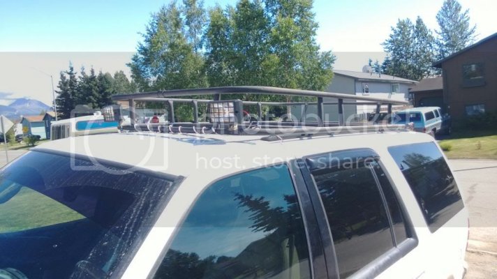

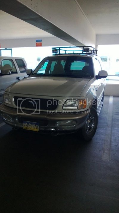

WP_20130709_014.jpg here's mine, made from EMT. 1". the wires aren't there anymore and still need to put a deck on it, still thinking of options. Very very easy to make. Just used u clamps and bolted to stock rails, had to make extra little lock nuts tho.
