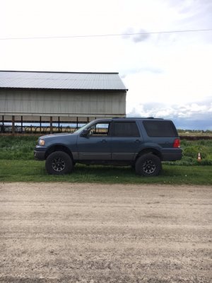

Looks great! Love that stance.
Any contact info for that company, would like to price getting a kit shipped to Kansas for my expy.

Here is the info that Performance Accessories states about the adjustable pedals on the F150. Don't see why it would be any diff on the expedition:
4. If equipped with adjustable pedals, operate the brake pedal button to ensure there is no interference with the steering U-joint or solenoid. If interference exists, slightly bend the brake pedal sideways
ExpeditionUser
Sep 14, 2013
58
Hampton Roads, Virginia
I just called the shop that has the picture of that 2004 Expedition with the body lift. They said that, it is indeed a body lift, and they used a 2004 F-150 kit. The gentleman said that the parts crossed right over and that the adjustable pedals were not an issue at all. I asked him to come here and do a write up, and maybe even try to be a vendor. I think I may make myself the guinea pig for this project in the next few months, if so, I'll do a complete write up, success or failure.
