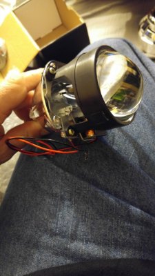

I have done a retro on my 07 and working on my second now with a higher end projector. The easiest way to get a retro done is with a Morimoto mini H1 from theretrofitsource.com. robbing parts from a Gator sounds good but considering the modifications needed to the housing itself out weighs the benefits. Your best bet is the Mh1 because it has a threaded shaft that will slide through the original bulb hole and have a large but to fasten it into place. The mini h1 will also blow a gator projector out of the water.

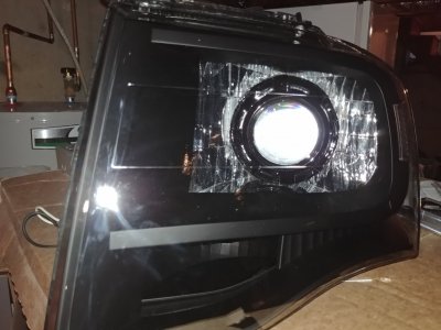

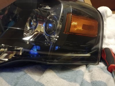

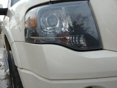

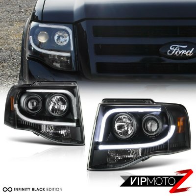

Not to bash what other people like but these really dont perform well and imo look cheap.

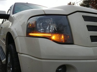

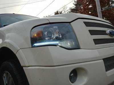

Switchback strips and leds can also be added to your original housing in almost any configuration you like but it just adds to the install time. I added a switchback strip to the blank area of my oems
This is more white than blue. Not sure why it came out blue

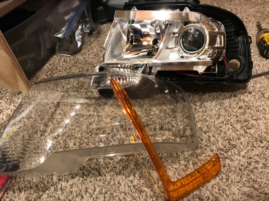

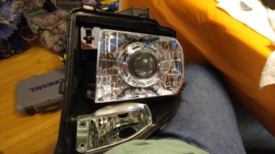

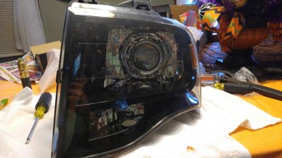

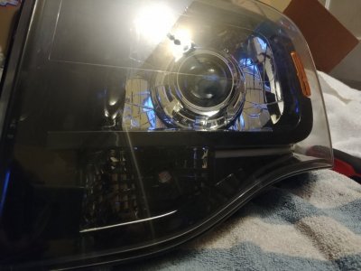

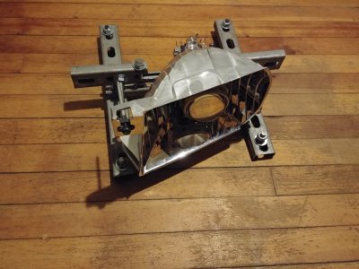

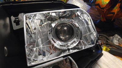

At this point I can not do any builds for other people. I have my second retro under way for the last 2-3 months and can't even find time to finish those. They are on the more difficult side because they are custom mounting so they take time but my kids baseball schedule is never ending so free time is impossible.
In the future I will consider simple retros (threaded shaft mount) for people here for a reasonable cost.
Couple pics below. They look close to done but not really... Still have some chrome thats gotta be stripped and painted, led strips gotta go in, shrouds need to be mounted (which is why ibhave glare above the cutoff). Soon enough though
