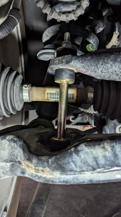

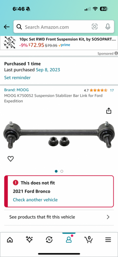

Uh Oh @Hellwig, let's see how long your end links last. I did both bars and for sure on the front, I've tried 3 or 4 different end link setups. I have posts on here on which ones i've settle on but they are universal ones from Energy suspension. The stock ones started popping in about 5k miles, the Moog ones were even worse. Seems any of the ones that use a ball joint style articulation can't handle the added strength of the new bar. I have to replace the bushings on my current ones again soon, but this time I'm trying some higher density Poly ones vs. the rubber/low density Poly stuff to see if they last a little longer. I've searched and searched and asked companies to make some heavy duty off-road style ones for these, and no one wants to.

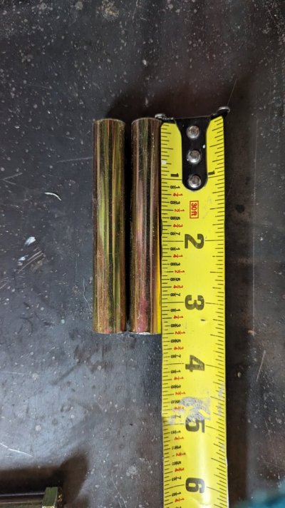

Energy Suspension 9.8121R end link set (only need 1, comes with pairs) - Dremel 1/2" of the brass spacers off before installing per previous post suggested in this thread

Also, I should say I found it easier to install the universal thread side up, easier to install the various washers and bushings as you push the bolt up through the spacer, etc., than trying to work against gravity, plus I don't like the threaded end hanging down possibly to scrape on something.
There was another post on here recently about using some heavy duty billet aluminum bar mounts. I've also tried at least 3 different mounts and so far the ones I'm using have been the best. I don't like ones that aren't greaseable as they get too dirty. I like ones with Zirks. I just can justify the cost of the billet ones yet, i'm hoping to see some feedback over the next few months. My issues thought have been the end links.
