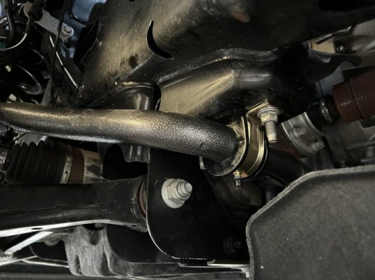

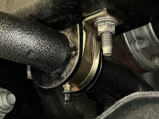

Experienced a similar situation after 6 months of driving my 2019 4x4 Limited Stealth with both the front and rear Hellwig sway bars installed. Replaced the front bushings with Energy Suspension Polyurethane 1-7/16 #9.5175G. Has serviceable grease fittings. No more clunk after first test drive.
K
KFordEx8
Feb 11, 2021
139
120
SF Bay Area
Experienced a similar situation after 6 months of driving my 2019 Limited Stealth with both the front and rear Hellwig sway bars installed. Replaced the front bushings with Energy Suspension Polyurethane 1-7/16 #9.5175G. Has serviceable grease fittings. No more clunk after first test drive.
View attachment 72593View attachment 72594
The bracket appears to be a better fit than the Prothane model that I got.
I think this is that largest Energy Suspension greaseable model that is made.
