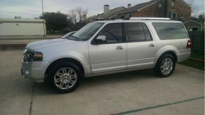

Bone stock and I've only owned it a week so far.
Picture from my phone, hope it comes through ok.

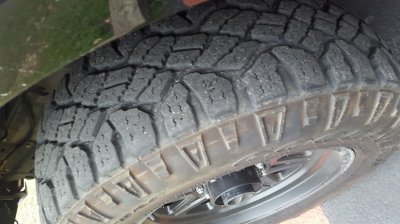

Duratracs at roughly 20k miles
Slow response here but I mentioned I would grab a picture of these with some miles on them.
Sorry about sideways picture from my phone
