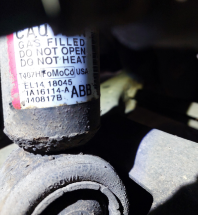

Help to identify these shocks?
effingpot
Mar 23, 2011
92
19
Hampshire, England
So the next challenge is that I need to replace my two front (leaky) shocks! As my VIN does not match up 100% on RockAuto and the others, it's prob best to replaced like for like with that is in there now. I managed to get the photo below but Googling around I can't work out what to order from RockAuto.
If anyone understands these things better than me (not hard!) then please do point me in the right direction.
It's a 2015 5.4L V8 XLT Expedition. Thanks.

That is a Ford strut, and appears to be original. See the FoMoCo? Ford Motor Company. This is the stock replacement.

OK thank you. Would that be the equivalent of => https://www.rockauto.com/en/moreinfo.php?pk=12730261&cc=3305849&pt=15174&jsn=560
That looks like the same P/N but also includes the springs and is a bit cheaper too?
And is there anywhere online that links the numbers on my photo to your EL1Z18124C?
I can't return bits from here (UK) easily to I have be 100% sure. Thanks again.
Let me warn you about using Monroe Quick Struts. I replaced my stock combo with the Quick Struts, because they cost less to buy and install. Well the spring rates were wrong as were the dampening rates and I ended up with a truck that was lower in the front than previous and bounced all over the place. 6 months later I ended up buying new Ford shocks and springs and throwing the Monroe's away. A VERY EXPENSIVE LESSON.

Thanks for the tip - I'm struggling to find the Ford ones on RockAuto (they ship to me in the UK quick and fair price which is why I like to buy there). But if I can find Ford there I'll get em.
^^THIS^^^
I learned a similarly expensive lesson years ago (long story), so since then, I wouldn't buy a bag of doggy poo from Monwrong even if it was the last place on earth to get it from.....

I do know alot of people have had good luck with Koni Replacements. I dont know the correct part numbers, but others on here do know.
