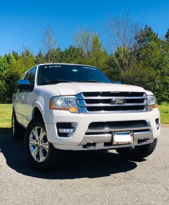

I Have an 08 Expedtion Eddie Bauer With the Factory 18" wheels on it. I'm looking to change the wheels and tires but would like to go with a bigger and wider tire, Was thinking I could swing 33's without rubbing and maybe 35s with a level. I'm trying to avoid spacers since they put a lot of strain on the wheels bearings. I would love to put the same style of wheel on as pictured below.
Thanks for the time and knowledge in advance!

Check out customwheeloffset.com
Gonto gallery and enter your year make and model. You will see what others have done and what size tires and wheels work with different suspensions setups.
And idk if you’ve ever had spacers but don’t knock em till you try them. I have BORA 1.25” spacers on my 16 EL Platinum on readylift 3/2 and 35s and have had zero issues. Install them and torque them right and you’ll be fine, don’t buy cheap eBay ones though

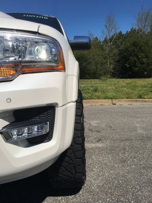

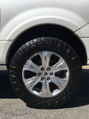

35/11.50/20 (actual with 47 psi is 33.2” x 11.3”) ridge grapplers
22CDB580-918D-4A33-8EB5-EECEDB3897FB.jpeg A2FE0B7B-8D6E-4996-8EBA-4E42416C7302.jpeg 0EEFD61B-73B5-4D8F-9947-D5E45994D7D2.jpeg BBF1A4C0-C991-4E0C-BA99-33ED341F8509.jpeg 0EB9B564-C9F2-499B-BB3F-CE8A24DF1595.jpeg
