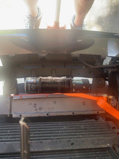

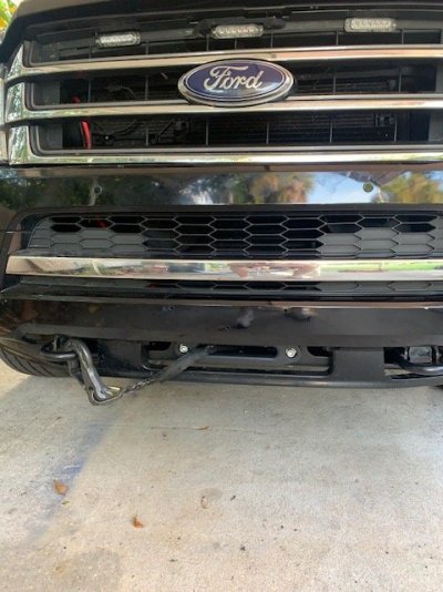

Thought I had posted this yesterday but I must have vaporized it at some point. Anyway several months back I installed a winch up front that turned out good enough that I think it's worth posting - you can draw your own conclusions..:
ready to install winch.jpgre-align interecooler.jpgdrum release disengage.jpgWinch view.jpg

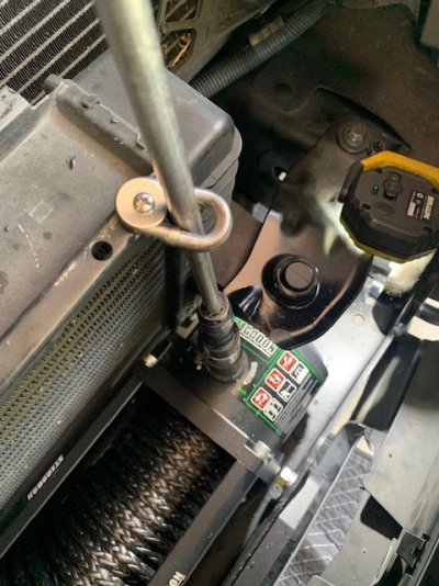

The winch "tray" is a universal product from Harbor Freight ($50) - very slight modification needed. I cut out the crossbar that helps hold the inter-cooler in place but retained the mounts for the rubber grommets which held the inter-cooler at it's new laid back angle. I didn't desire a big hole in my grill to access the spool clutch so I devised another method to engage-disengage the spool - that's 15" 3/8s extension connected to a slotted o2 sensor socket - it works... If you look closely you can see where I cut off the mounting bracket horizontal bar. I've made several trips to TN & back with no issues so I guess all is okay. Very few people I know have noticed the winch unless I point it out to them.. Note: my apologies in advance if this thread is duplicated somewhere else of the forum.

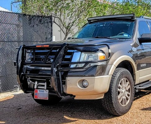

I have full skid plates, transmission cooler and a hidden winch installed with the Rough Country hidden winch plate for the F150. The only mod was drilling a third hole into the frame (where the F150 has an extra hole) and relocating the winch solenoid to not bump the transmission cooler. The RC kit has a solenoid relocation plate that works for the Expy too, so that was nice. I also welded tow hooks to the plate but that is definitely optional. I used the roller lead since i prefer steel winch cable and it's a little more obvious, but if you run synthetic winch line instead of steel you can have a much more subdued fairlead.
