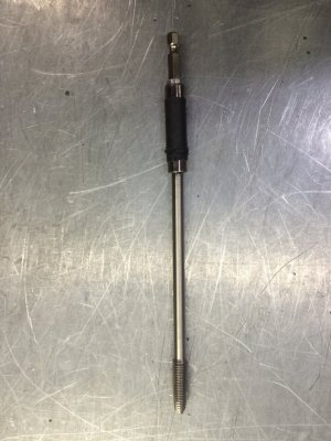

Anyways 3 days ago I get a misfire code so I decided to replace plugs, I got a lisle tool 65600 and new plugs and got to work

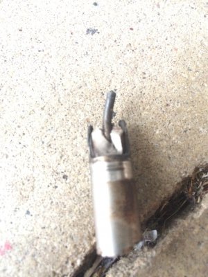

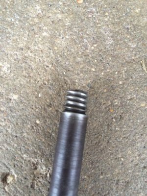

Now the fun part: all 8 plugs broke in 3 pieces, 7 of which came out without any struggle using the lisle tool but lucky plug #3 (the one that ignited the CEL) decided it wasn't coming out, after repeated attempts trying to remove it the lisle tool stripped and with that it also stripped the electrode.
1. I bought another kit in hopes it grabs the electrode but it wouldn't catch,

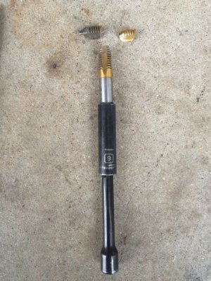

3. I got a 3/8-16 extended tap 6" long, tried to tap the electrode but all it did was strip off the top lip of the broken electrode and it kept breaking piece by piece

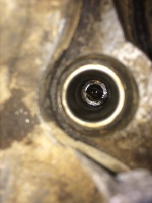

5. Started to tare down the intake thinking I have to remove the heads now... Then in the mids of it I decided to beat the living hell out of the electrode using a 1/4" drive 12" long extension and a 4-lb sludge hammer and I just started pounding at it (I was very angry)
To my surprise 10 minutes later I go to remove the extension and it's stuck, so I kept wiggling it until it came out.... Then it hit me, the square tip has created a dimple inside the electrode which might be just enough for the lisle tool to grab onto, and holly smokes it grabbed it and pulled it out
Though might I remind you the electrode got pushed so deep that I couldn't get the nut on the puller screw using the spacer that came with the tool, I had to use a 1/2 drive 13/16 deep socket and a 1/2" SAE washer on the bottom and top and as I screwed the nut it actually worked.
