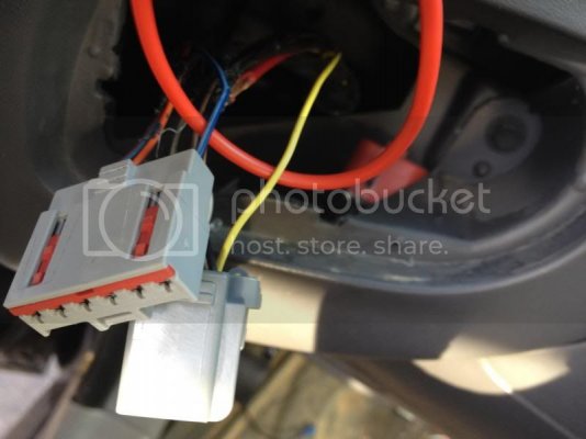

So here is the remote/keyless entry module located under the steering column on the fire wall.
I couldn't find any schematics (no where online) for the box or the plugs, so i decided to take it apart to see what we were dealing with.
Looking at the picture above, I noticed: the three relays, (one that clicks when locking the doors). So i traced the input/outs to the 555timer/microchip. Their are 4 on the unit, but only one of them ran to the grey wire which can cut power to the perimeter lighting. Thus I traced that pin to the 555timer and sure enough, the 555/mircochip is controlled via a common threshold of 1/3 v of the output. This means all the light flashing via the keyfob is controlled by the grey wire. Moreover, you can't disconnect only the low beams or parking lights by this module. You can only disable both of them.

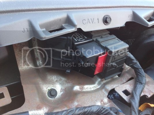

Once I figured that out, I had to trace the grey wire to a couple of relays, the ECM, and then finally to a box of relays under the passenger side dash panel.

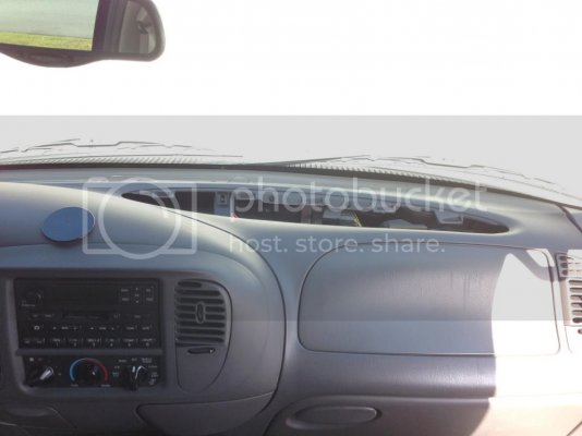

Note: the box we are talking about is to the top right (on the passenger side dash, it is a big oval plastic over) it will have a plastic cover over the top that is about 2 feet long and 6-8 inches wide.
There is a small clip on the bottom of the box you need to pretty up to pull the box off the dash. Once you get it off the mounting bracket, there are two clips on both side you need to pull out to get the cover off.

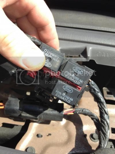

Here is what is revealed.

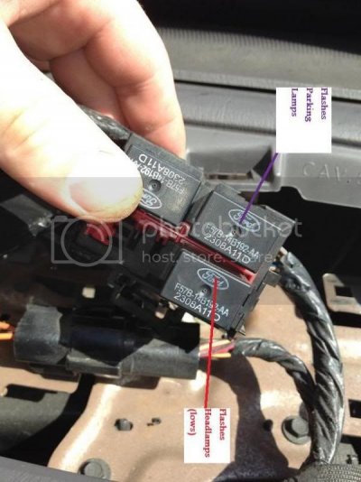

I found 3 relays in the box and used my DMM to see which ones we need to look at. For simplicity, notice the way I am holding the box, it is in the same position as they were mounted. The top right and bottom right relays, are the only ones we are concerned with.
Now to simply disable *ONLY* the low beams when using keyfobs, pull the right bottom relay out of the box.
For those of you who dont want to enable fogs/aux's to flash, you are finished. All you had to do was pull that relay. Panic and everything still work, just the low beams wont flash using any of the keyless entry methods. This also disables DRL unless you cut pin 87a on the relay. Not a big deal considering the DRLs dont work half of the time.

With the bottom right relay (low beam) removed, we know we only have to worry about the top right relay(parking lamps) to trigger our fogs/auxs.

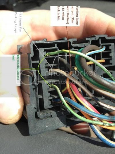

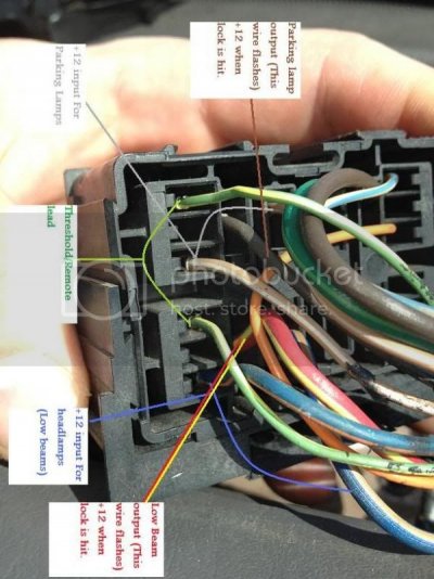

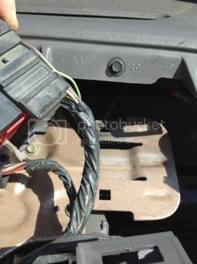

So flip the box over and check out the wiring.
Note: The Parking lamp flasher relay is one the top left in this position.
Some diagrams to follow:
We no longer need the low beams circuit.
The low beam relay we removed was connected to the larger Red/Yellow and Blue/Orange wires. We aren't concerned with these, I only labeled them so you know not to touch these.
The only wire we are concerned with, is the Dark BROWN wire on the parking lamps relay. This wire flashes +12V when the lock button is hit.

Pulling the relay still lets your parking lamps flash. So confirmation of "locked" should be an issue. You can wire it up to work with any of the lights. Just let me know what you want to do, I just added some of the most popular routes.

could you clarify which part of the driver side dash you pulled the relay? I am not near my expe right now to take a look and see the lay of the land. I dont remember having anything on top that I can pop off other than the passenger side (above the airbag)

I updated it, to give members a better idea where it is at. It is not located on the bezel/dash you posted in the last picture. It is on the very top of the passenger side. Big oval piece (cant miss it)

Done! and you werent kidding about pulling the sockets out. decided to just pull the relay with the sockets in place
