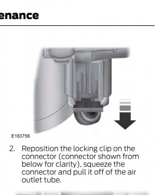

I have read the manual and searched YouTube for videos on how to do this. On all the videos there is a red locking clip. I don't have that.

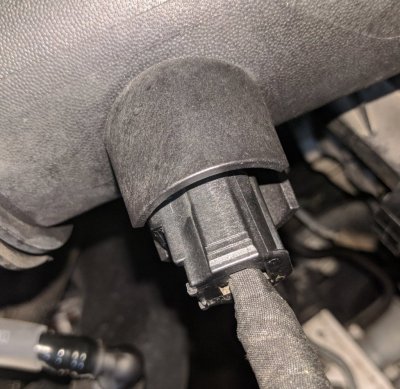

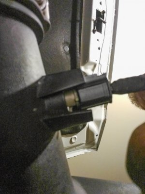

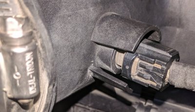

My problem is I cannot find the locking clip to disconnect the MAF electrical cable.
Below are pictures of my MAF electrical cable.
I would be very grateful for any help learning how to disconnect this cable.

The illustrations and instructions in my vehicle owner’s manual are incorrect (apparently as is yours too).
The connector is very easy to remove. If I remember - just push on the side of the connector (your second picture), wiggle a little and pull the connector out. Once you do it, it seems to be much easier than the incorrect Ford instructions in the manual.
