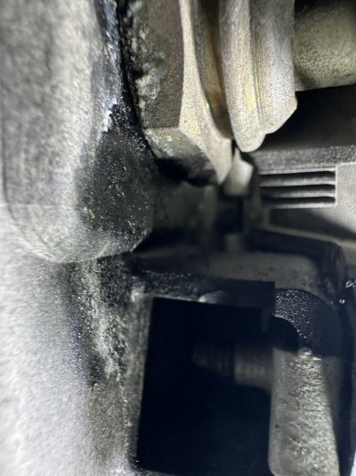

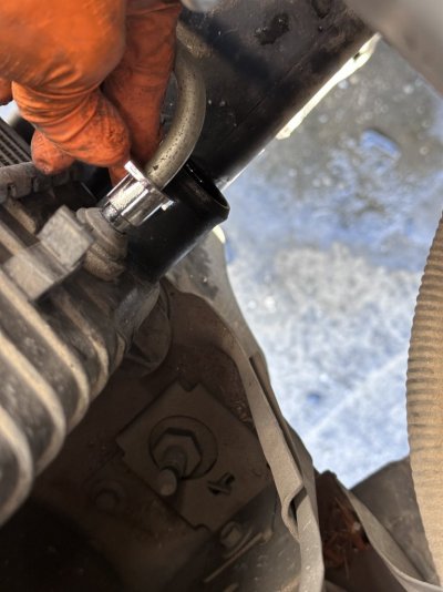

I completed the practice run at the junkyard today. Learned some good things and came away with some food for thought on my process when I go to do this.
What was learned:
To remove the fan shroud disconnect the top transmission line to move it over enough for a socket and ratchet. I don’t have a tiny ratcheting 8mm wrench. Otherwise I will had to go slow mode with a 8mm wrench.
Easiest way I found to remove the clutch fan was to attach a 10mm wrench to a bolt on the water pump pulley and rotate it to be 90 degrees to the right (driver’s side) and then put a 1/2 inch socket on the pulley right above to to act as a stop. Without that socket the wrench won’t have enough resistance to stay under the pulley. Fan came off no problem after that.
Disconnecting the lower radiator hose is necessary to more easily remove the lower transmission line. It was such a tight space and the removal tool did not want to fully seat and allow for pressure. So I used a breaker bar to push the disconnect tool in while also leveraging the line out. Photo below shows the difficult space to work in.
If I take my time I will have no problems with the removal and install.

It feels very strange, but I push the trans line release tool in until it just barely clicks/releases. Then pull the tool and the line together and the line comes out easy. Any other way I have struggled to the point of anger.
BigRed2004
BigRed2004
Sep 8, 2021
64
28
Las Vegas, NV
Thanks for the advice @whtbronco. I was becoming angry with that bottom line, but I was just working through the process at the local pic-a-part to understand everything. For all I know when I do it on my EB it’ll be hassle free like the top one was.
