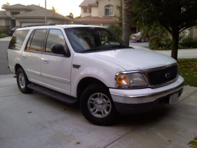

Hello, i need a hub assmbly for a 2000 eddie Bauer Expy,
its 4X4 5.4. The parts guy ask me if it has 12mm or 14mm studs (i think)
but when i go online to order the part, it doesnt ask that? Which one would i have in my 4X4 EB? Thanks guys
