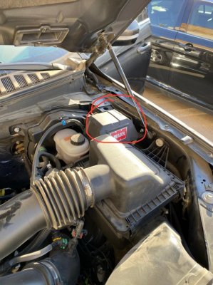

Alhrir, I wish there were more pics lol.
I think there is also an intercooler relocation kit that some have made/bought and considering it is hot all the time there maybe a larger IC might help too.
I wish pulling the nose cone was an easy affair, I'd love to set my amateur engineering brain on this one, maybe try to get some more air to the cooler or add a fan or two...
Did you upgrade the battery?
