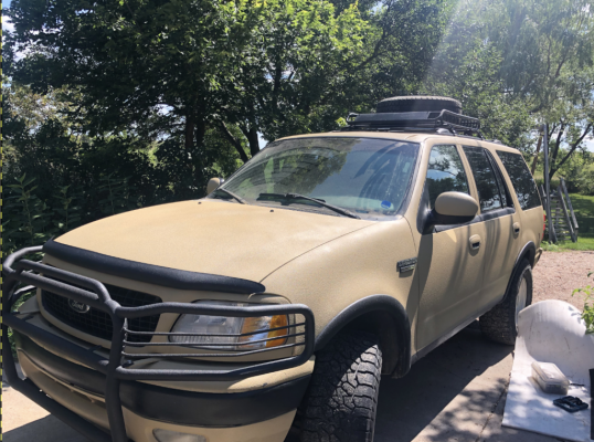

Hey everyone I've been lurking here while I work up some good questions about my new to me (2000 Eddie Bauer AWD 4H 4L Expedition 5.4)Aug 15.png
First a bit about myself and this truck.
When I was a kid my parents had a new 98 XLT that served us well and ever since then I've had a soft spot for these things so now that I'm getting ready for college I decided to upgrade from my 85 CUCV (kept it of course) to my expedition, I got it from a guy who had it for a year and didn't take care of it at all but before him I have a long chain of receipts showing good maintenance and the crown jewel, a complete engine and transmission rebuild about 60,000 back on a total of 170,000 miles on the truck. I've had a ton of fun painting and adding accessories as well as doing an oil change and flush, dropping the transmission pan and draining the torque converter, replacing a few vacuum lines to fix the AC and cleaning the throttle plates. Now, I will admit there are still a few issues: First, and probably worse of all, when cold started it has a nasty rough idle that surges and nearly stalls (video attached if I can figure out how). This clears up once the engine is warm. It also has some bad but not unsafe rust and a big handful of small issues - rear wiper doesn't work, it pulls right harder than I would like, missing a fog lamp, passengers window won't roll down all the way, and a few issues with door locks.
Alright, if you made it this far thanks for reading and if you have any advice of any of the issues or really anything else I'd love to hear it.
Thanks everyone!
Nick
P.S. Couldn't figure out how to attach the video so ill describe the rough idle issue.
Start truck, maybe 1 second crank, rpms maybe 12-1300. Slowly and steadily fall to about 900 hold for a bit then fall and shake until 500 or so then kick up to 1200 and repeat until warm when it seems to settle down around 900 (which I think is about right)?
