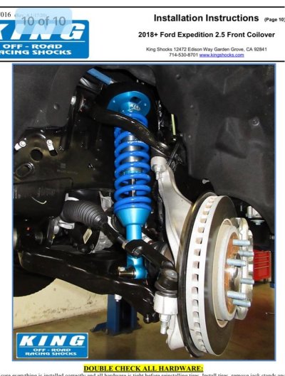

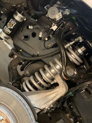

Just got off the phone with Kings and they are offering a suspension package now. The price is very close. Any opinions on which one is better.
Also the Border Patrol has expedition with the Kings.
Kings- total shipped no upper control arms = 4000.00
Icons- total shipped with upper control arms= stage 2 = 4200.00

Icons are valved and set up to match the vehicle. Kings are great but the do need to be dialed in and they're excellent as well.

If your truck is DD I'd stay Icon. I haven't seen the specs on the Expi king kit but if there are bypasses king bypasses are quite noisy and they click everytime they start to compress, ie hit any sort of bump. Icon and fox are much quieter.

I ask the rep about the bumpstop but he said they dont have a kit for expedition. He said they have a bumpstop that I would have to weld and make a bracket for it.

I have never seen kings show up in a box that did not need to be tuned. Are they telling you they have them set up for the Expy? Do they have Comp/rebound adjustments? What’s the ride height adjustments? If you spent most your time off road it’s “Good To Be King”. Everything else Icon is more then enough.

The lift adjustment is 2inch in the front and one inch in the rear. Fuzzy they are specifically made for the Expedition. They started making them because the Broder Patrol requested the shock for thier needs.
