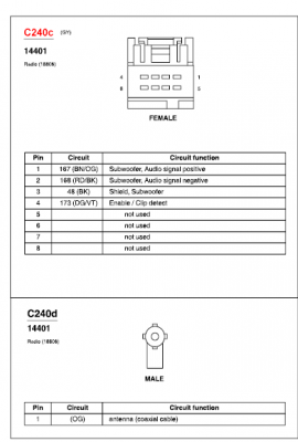

used a multimeter and tested the AFDI-5V converter, it's coming out at 5v (5.34). What color is the wire at the factory harness? Pin #4 on the harness?2011-06-19_021702_2.png
