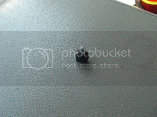

I'll check for you later on this afternoon since my dash is dis-assembled. If I have an extra one hanging around, I'll even send it to you since I am here in Richmond.

Here's a photo of it, but sorry, don't have any extras.

thanks yea i had it out...just wasnt sure of the bulb number

K great thanks...was actually going to do that this weekend....now i know what to get
