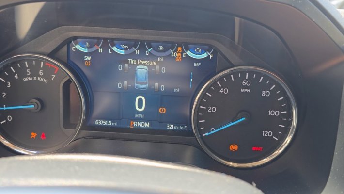

I wanted to ask if anyone has the answer to this. I've been playing around with options and settings and cannot figure this out for the life of me.

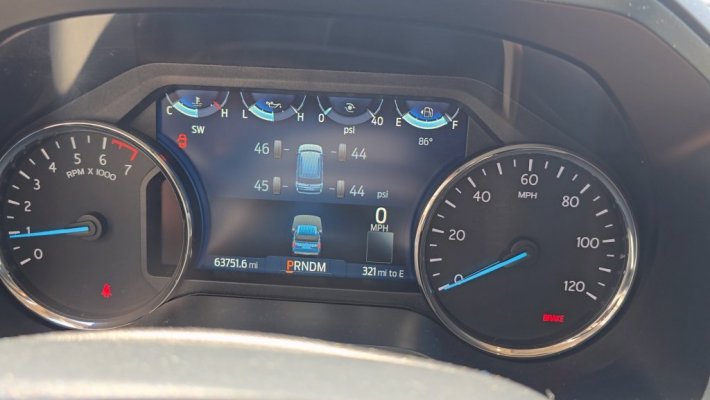

Basically, when I start the car, the bottom part of the display shows MPH in nice, big, numbers. A few moments after, it changes to the radar's display and relegates MPH to the right side of the screen in small numbers. Is there a way to use that bottom middle part of the screen for something more useful?
When car starts:
After a few moments:

What year, what model? On mine, using the left side steering wheel up/dn, l/r, select buttons, I navigate to different cluster settings and pick what I want.

It is a 2023 Limited. I've tried reviewing options on the right hand side of the steering wheel (where I can see the display's options) but there's nothing there that addresses this.

I found this for 2023 Expedition settings:
Go to Settings on your car display.
Navigate to Driver Assistance Settings.
Select Pre-Collision Assist.
Turn off Distance Collision Assist.
Your speedometer will now appear in the center of the display.
Let us know if this works?
R
revv
Jul 18, 2025
16
SoCal
Thank you!
I went into that menu, but it has slightly different working. That being said, turning this off made the speedometer come back in big and bold numbers.
