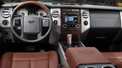

2009 KR:

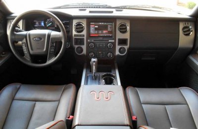

2017 KR:
Main differences are just center stack and instrument cluster. That and the 07-14’ trucks use the Super Duty F-250 steering wheel vs the 15-17 using the F-150 steering wheel.
