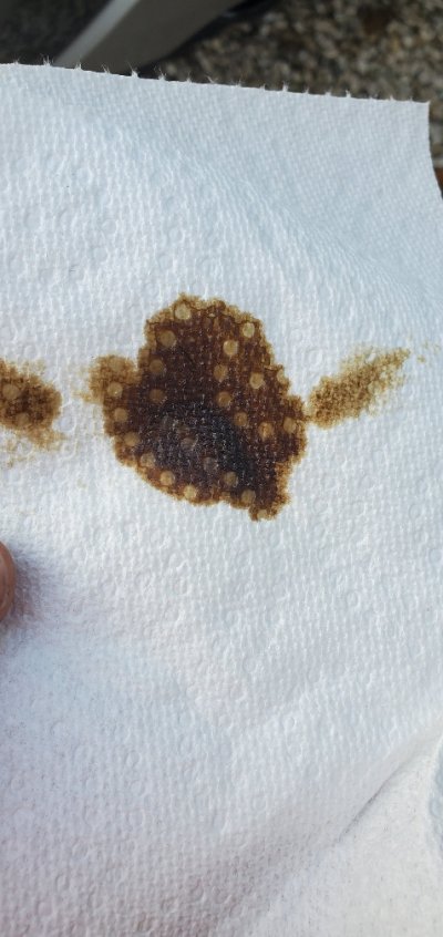

Sorry, posted in the wrong catch can thread earlier... filled about 5oz in 500 miles with the extension. I'm not convinced it's normal but I can't really figure out what normal would be. Anyone have any thoughts? Photo is what the oil/ water mix looks like in a paper towel. Really glad I got the extension.4701cd31cbb8a39b1b9df596d0724e31.jpg

Sounds like a lot of blowby based on my experience. I have the JLT 3 oz catch can and I maybe have it 1/4 full (less than 1 oz) when I check it at each 5000 mile oil change. This is just normal driving with no towing, so maybe if you are towing heavy all the time it would have more blowby.

No towing in this 500 miles and most of the time its in eco mode. I'm new to turbos, how would I confirm having to much blow by? And is that a warranty type issue?

If you figure 5 oz every 500 miles, that would be about a quart every 3000 miles, so I'd be checking my engine oil on a regular basis if I were you. I would discuss it with the dealer, but you'll likely need to document a pattern of oil consumption to help your case for a warranty claim.
