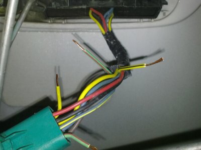

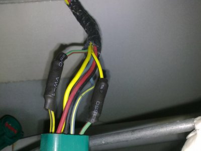

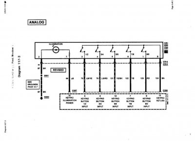

All the forums and the ford dealer are correct in that you cannot change the master code. You can however change the sequence of numbers that you push on the keypad to something entirely different therefore in essence, you can change the code.
If for example your code is 12345 you can change your keypad so that 12345 no longer works and 55341 is what you actually push on the keypad to open the door.
What you can do is cut 2 wires coming out of the keypad and cross them. If you really want to get tricky you can do more wires but for me 2 was enough.
I was going through pure hell as my ex knew the master code, told her loser of a boyfriend what is was and he was enjoying stealing my stuff and leaving me nasty surprises for me on my seat. It took me a Sunday afternoon of going slow so nothing got broke or damaged but it was sure better than the $1200 my dealer quoted me.
