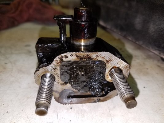

It's not a cold weather issue, it's a cold start issue. After it has been sitting and given enough time to let the oil drain back into the pan.
As far as the timing tensioners, they don't have to leak to not pump up. When I tore the motor down in my son's Mustang when we bought it, this is what the tensioner looked like. Previous owner didn't believe in oil changes apparently...
