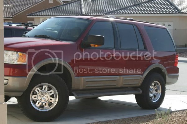

After reading and researching and coming up empty time and time again, I decided to post my 2004 Expy project. I was never able to find pics or answers to many of my questions. Here is my experience:
I wanted to do something different and I think I did.
Truck: 2004 Ford Expedition Eddie Bauer 2WD - $15000
Lift: 3/2 Truxxx lift - $85 from ebay (yes it was new!)
Wheels: 17x9 Polished Centerline Forged wheels - $556
Tires: 315 70 17 BFG A/Ts used - $240 (craigslist find!)
Exhaust: Magnaflow 22x11 polished 3" exhaust w/4 inch tip - $250
Intake: K&N FIPK - $150 (ebay steal!)
Lessons learned

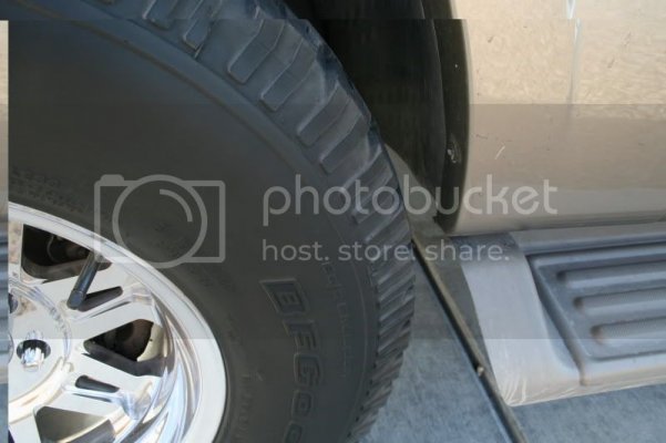

- Trimming is absolutely required regardless of what the lift instructions say! The factory running boards extend too far into the wheel wells, front and rear, expect to shave off the ends. Also need to trim inner fender lining and front bumper
- Your speedo will be off the faster you drive. Under 40 mph is negligible but at highway speeds, refer to your GPS or simply buy a programmer
- Gas mileage will suffer! I took a 4 mpg hit from the stock setup. Again, a programmer could only help here
- It WILL FIT in the garage!
- The BFG's are loud. They definitely sing as you roll down the road
- Finally, modding your truck is contageous! But I think everyone here already knows that!
Future Plans
- Bull Bar
- remove the factory running boards and replace with nerf bars
- Programmer. undecided as to which brand I'll use
pics
IMG_0257.jpg]

well it does look good! im surprised the tires are loud though. most a/t arent loud at all. for programmers most people choose the edge. seems to be a very reliable programmer and has lots of options depending on what kind of driving you want to do that day. lookin good though.

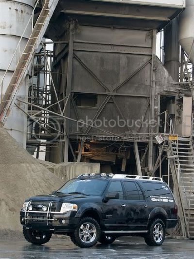

Hmm, I'll have to check on that. I know there was a prototype bodylift on an Expy EL I saw. Cant remember the name of the company, but it was in one of the off road magazines.
