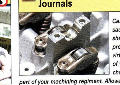

The overhead cam mod motors do have hydraulic cam followers/ hydraulic lash adjusters/ slack adjustors which ever term you prefer to call them that resemble lifters. Many people still call them lifters although they are technically not. These are used to maintain zero clearance between the cam lobe and roller rocker just as hydraulic lifter would. On one side of the rocker you have the valve and the other is the "hydraulic lash adjuster" with the cam acting on the middle of the roller rocker. The lash adjuster is the pivot point of the rocker. Lifters is a lot easier to say and most understand what you are refering too. See if I can dig up some pics..
Found in ford modular rebuild book..
lash adjuster under rocker on left. Valve on right. Cam lobe acts upon roller in middle of rocker. Cam is missing of course in this photo. These work by oil pressure just as a lifter does to maintain zero lash.
These can have the same issues as a lifter does if it cannot maintain zero clearance as designed thus ticking.
But as said earlier...exhaust leak around the heads is very common with these motors when the studs break off. Makes a perfect ticking noise.. :)
These are also known for ejecting spark plugs. Make sure a plug has not worked its way loose. Many times these will also make a ticking sound before ejecting the plug.
